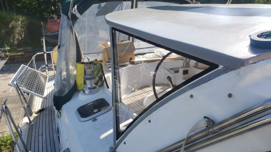

In case anyone wants to see what I'm working with:
IMG-20250422-185238 hosted at ImgBB
I agree that plastic windows stuck straight onto the hull are not the most aesthetic looking windows. In your shoes, after getting the new windows cut I would fill all the holes in the hull with an epoxy mix so I was not worried about aligning old holes in hull with new holes in window. I would not glue the window on as it is a temporary measure at best and likely glued on in less than optimum conditions.
On the new window, fit Scapa 3507 bedding tape, 3mm thick, around the inside edge of the new window, cut to be the same width as the window to GRP width. The tape is superior to mastic seal and very easy to work with. I would buy some half round bar and carefully cut to fit the new window, likely I would use play or balsa strips the same width as the half round to make templates first, before cutting the half round bar. Drill the half round bar at an appropriate centre spacing for the new screws and counter sink the holes because I would use counter sunk dome heads in stainless. Fit the window to the hull and then use duck tape strips to temporarily hold frame and window to the GRP. Drill the GRP and then coat the stainless steel screw with Duralec or Teff Gell (Teff Gell is better). Wipe of excess Teff Gell / Duralex while still wet, align screw heads for neatness.
Personally that is not 10 times harder and you will have a neat windows. Even if you don't use the aluminium half round bar, use the tape. I am coming on 7 years now with my tape and frames and not a drop of water has come through and still robust.
