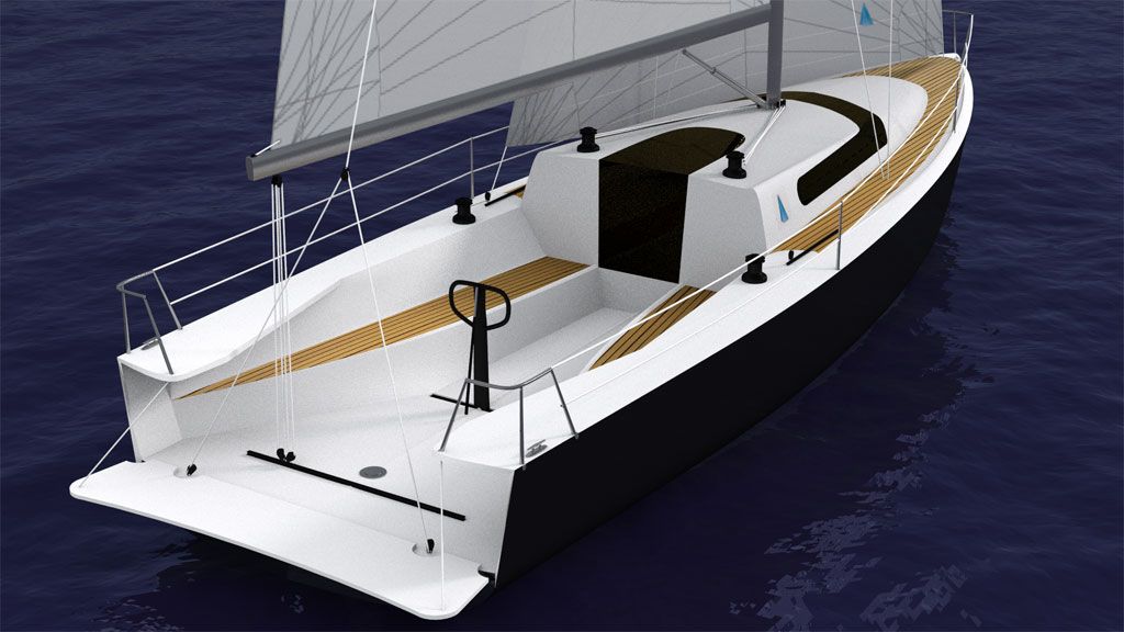

Re Hallberg R’s whipstaff

When I used to use yard workboats a bit, waaaay back when, the whipstaff steering à la Haslar was brilliant when bringing in a customers boat strapped alongside.. again, hands free.. wouldn’t do it now though..
I was not aware Haslar had designed the cruising boat you show, thank you ! Food for thought based on lots and lots of time spent at sea !?
Yes, it's good to brainstorm laterally as it provokes other ideas from them wot is wiser than oneself.

I have an archaic Hasler SP. It's possible to Heath Robinson a tillerpilot onto it but it leaves it very exposed. Pictures would be good. Does it activate via a pivotted lever set up?
Some Fairey Atlantas have been, I think, redone with a whipstaff set up instead of a wheel. Funnily some modern designs are revisiting the idea. At present, I'm playing around with a rudder > tiller > lines > vertical 'staff in front of me like a simple joy stick. It's more of a duckpunt than a skiff really.
