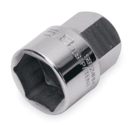

Indeed, hence the question. Where can I get a 24mm socket with external flats?
If you want to use the allen key. ie you can't hold the pulley tight enough as described... I would use a piece of rope twisted to tighten it around the pulley. Put the twitsted end in a vice to hold it.
... Then you will need to grind flats on the outside of the socket enabling it to be held by vice grip pliers or possibly a crescent spanner. You will need to use the allen key long leg in and short leg out to turn so will need an extension on the short leg of the allen key. good luck I hope the extended pulley works out. olewill
You need what's called a pass thru socket set :)
Or, if you already have them, save the money, put a socket on an impact driver ;) tried and tested method of achieving what you want to do.
Always a little wary of whacking an alloy casting (ie alternator frame) in a direction its not well supported for by using an impact driver :)
