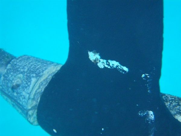

1) I dived down and and saw a hairline crack going around the p-bracket about half way down, but I couldn't feel any play in it, but that's not to say that there isn't play when there are greater forces acting on it. Does this crack mean that the boat should be taken out immediately and repaired? And would it just need sheathing in glass mat? I'm at a place where it's very cheap to get hauled out at the moment.

As a follow up, I was able to dive down and take some pictures and check for play in the cutlass bearing yesterday. I couldn't feel any play in the bearing, but visually inspecting it was difficult.
I've noticed that the thumping occurs mostly after I've been in reverse, then go forward. So perhaps it's the prop blades not setting properly?
In the pictures you can see where paint has come off at the point of the crack on the p-bracket. There's no play in it so hopefully it's just the glass fibre sheathing that's cracked. Am I being reckless if I leave it until the next haul out (in October before we cross the Atlantic)?

N.B. Those shaft anodes are only 1 month old, is that normal corrosion or is there serious stray current somewhere?
blimey that's a big prop which could cause twist on the shaft when you first put it in gear. How ever I would suggest you get the whole lot looked at by a marine engineer along with what every one else has said, I also suspect the gear box
