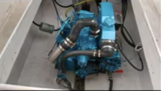

Here's the engine. I'm not familiar with these models but looks very tidy. Looks to me that it could be a twin (2020?), rather than triple, but might just be the angle etc.

That looks like a Perkins version which is painted that colour, or has just been repainted before installation. The air intake is non standard, but probably because the normal one pokes out at the back of the head and may foul something we can't see. Definitely a 3 cylinder - you can see 3 fuel pipes to the injectors. Far too powerful for the boat but will trickle along nicely.
