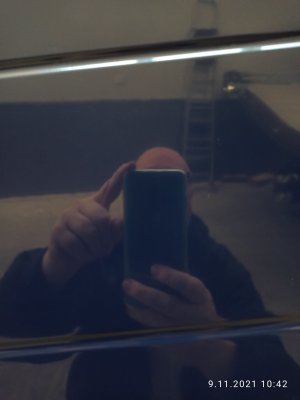

I also give Rupes a vote. I have a 21 Big Foot and use a short-pile lambswool flexibad 160mm pad. It's suitable for buffing and polishing work. First-class results and no risk of burning the gel coat. I ' m working hull 12*4 m about 10 hours and look pic "blue mirror surface"
