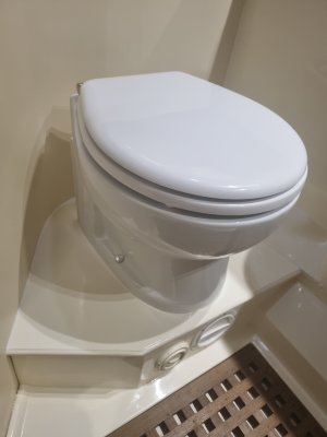

He meant a GOOD electric toilet. A fresh water one. Planus, Tecma, etc.
How is it a "game-changer"? Let me count the ways:
1. No more calcification of hoses. No more need to keep flushing for a long time. Because fresh water doesn't react with pee, and your hoses stay unsclerotic.
2. No more clogging. Because a powerful macerator liquifies everything, even TP.
3. No more pumping and pumping.
4. No more worry about sea water getting into the boat via a stuck antisyphon valve, etc.
shall I go on?

Go on, I am intrigued. But let me correct all the above for you first. No more pumping is the only benefit you have listed.
A Lavac with the antisyphon loop at high level doesnt syphon. They don't clog if you pump sufficiently. They don't calcify if you pump enough.
No need to waste fresh water to pump your loo, just pump sufficiently. If you were describing a Jabsco, I could understand, but the Lavac pump volume per stroke is vastly more than the tiny little Jabsco pumps.
Fit a Lavac, pump sufficiently and you have a reliable manual loo that doesn't rely on power or fresh water.

Lavac. They look crap. They are hard to clean. with pipes, nooks and crannies. You have to explain them to guests. The seals go. Horrid things.
But an upgrade on an electric Jabsco.
exaclty. So the loo is trivial in power drain terms. And the comfort upgrade is huge.
I have loads of solar and a large lithium bank that is more than capable of running electric bogs, but I simply don't want them. The number of fellow cruisers that liveaboard and have macerator pump failures is very noticeable.
A liveaboard use of the boat is 5 times the use that a prolific weekend sailor spends aboard. One year of liveaboard boat use is equivalent to 5 years for none liveaboards. Stuff breaks. Electric toilets are up there as stuff that breaks. When you are away from the UK, sourcing parts is way more difficult
