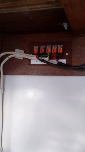

No space inside the light base.You could try WAGO inline splicing connectors. Work for me.

It is a sealed LED light so the wires will have to be joined somewhere.can you replace the wire on the item so its longer and accessible outide the item ?
