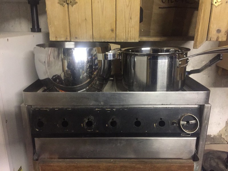

How about the size of pans you can fit at the same time? At sea I like to use deeper pans to avoid spillage of any sizzling and boiling bits of gourmet Stocks and broils on my beautiful peach skin, if possible. I’ve seen some where you could not fit anything bigger than a small pot besides each other. I do like the opportunity of a somewhat calmer moment to use a 3L to get some chow for 2 meals if possible. I think the 3L are 24 cm base. In that sense I rather fit 2 of those then 3 smaller ones. Reason why i'm asking.

Look at the dimensions and check. I fit 4 large pans on with no issues.

I have an older Force 10 in my workshop for refurbishment. I just took this picture, that is 2 x 23 cm pans on the front two burners, as you see there is plenty of room. The same size could be fitted on the back 2 burners simultaneously.
Untitled by Rival Sailor, on Flickr

Cool, that’s exactly what I was wondering. Thanks for that. Last one I tried to use to cook for 5 people on board was a funny gimpy thing that was horrible. If more then one then only small pans at the same time. Don’t remember the brand or the model but left me rather unimpressed with the all contraption. Cooking was a nightmare on that thing. Ended up giving up on cooking and just warming ready made meals on the oven.
Appreciate the pic. Thanks.
