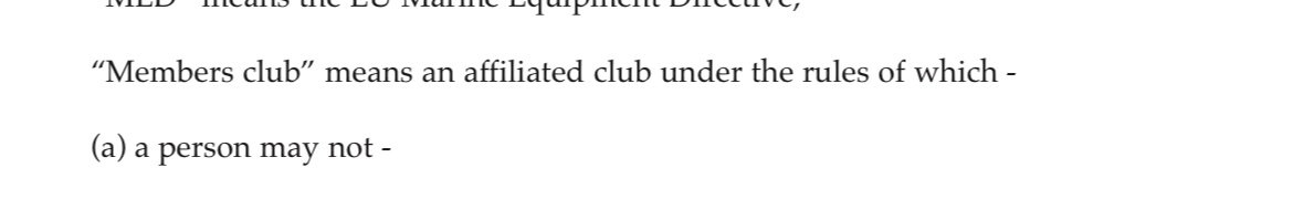

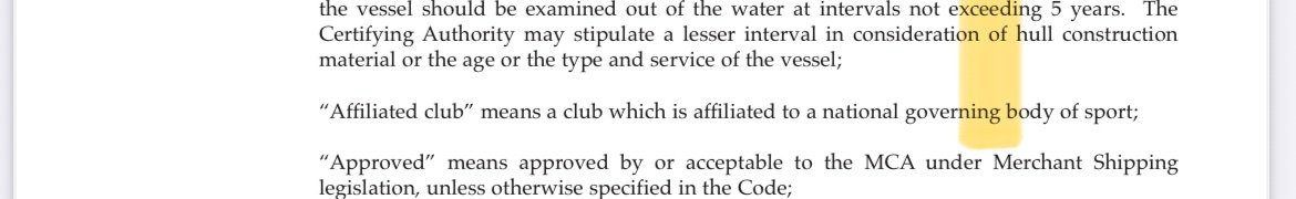

It depends on if the club meets the requirements listed in the definitions section of the document. If it doesn't meet the requirements, then it is commercial.
“Member’s Club” means an affiliated club under the rules of which:
(a) a person may not -
(i) be admitted to membership; or
(ii) be admitted as a candidate for membership, to any of the privileges of
membership,
without an interval of at least two days between their nomination or application
for membership and their admission.
(b) a person who becomes a member without prior nomination or application may
not be admitted to the privileges of membership without an interval of at least
two days between his becoming a member and his admission;
(c) any profits of the club may not be distributed to the members of the club;
“Pleasure vessel” as defined in the Merchant Shipping (Vessels in Commercial Use for Sport or Pleasure) Regulations 2025 (SI 2025 No. 1195), as amended, means:
(b) any vessel wholly owned by or on behalf of a member’s club formed for the
purpose of sport or pleasure which, at the time it is being used, is used only for the
sport or pleasure of members of that club or their immediate family, and for the use
of which any charges levied are paid into club funds and applied for the general
use of the club.
where, in the case of any vessel referred to in paragraph (a) or (b), no other payments
are made by or on behalf of users of the vessel, other than by the owner; and in this
definition “immediate family” means, in relation to an individual, the spouse or civil partner
of the individual, and a relative of the individual or the individual’s spouse or civil partner,
and “relative” means brother, sister, ancestor or lineal descendant
“Affiliated club” means a club which is affiliated to a national governing body of sport; (RYA for sailing in the UK)
