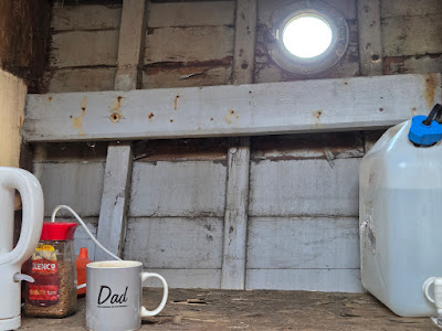

At last I have a galley work top to put the kettle on and make a brew while working on Chance. I just need to get the Microwave from my workshop and I will be able to heat up food while working on the boat without having to leave Chance. I do have a camping fridge onboard so I can keep food onboard over night when needed.
I do have my mug from my son onboard a present from a couple of years ago on father's day

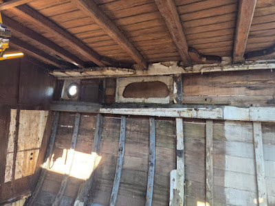

The window is blanked off as is the chimney hole which is one of the holes which as to be filled in as the cooker is going back in its original position in the galley space. I just have to build a new framework to sit it on after the other work in that area of the boat is done.

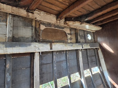

The port side window as been blanked off as well and so as the vent for the diesel heater which was fitted to the main bulkhead at the front of the main cabin.

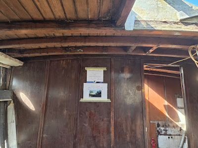

The diesel heater was originally fitted on this bulkhead below the restoration project sheets on the bulkhead and will be going back on this bulkhead later in the restoration

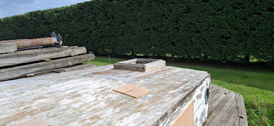

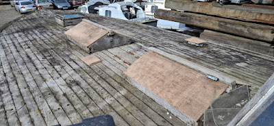

The skylight as to have two blanks put over it as well as the skylight in the galley space, then I will put a waterproof cover over the skylights to keep the rain out of the part of the boat.
The next job will be to get some plywood to blank off the starboard side deck and the two hatches on the foredeck and aft deck. Once this id done then the boat will be a lot more watertight and I can get on with work on the inside as well as the outside.
The skylights are now covered with plywood while we work on the rest of the boat. The skylight hatches are now varnished and in storage until it is time for them to go back on once the base part as been restored to its original condition and varnished again.

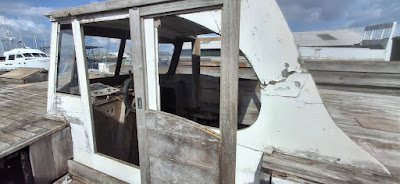

The sliding doors will have to be removed and repaired as necessary and new glass made and fitted once more. There is also some work to be done on the wheelhouse side where it as been damaged and not repaired very well in the past.
