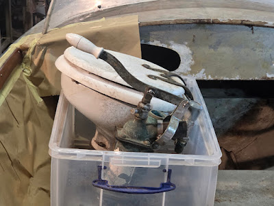

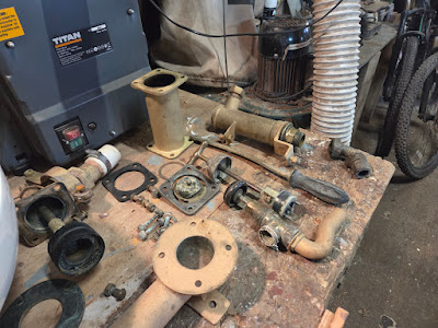

.After a long while doing other jobs on Chance. I thought it time to deep dive into the ship's toilets and show the inner working of these classic marine toilets. The one in bits is the original toilet out of Chance's aft heads compartment and the other two toilets are toilets that I have collected over the past few years in or=der to rebuild the original toilet. However there appears to be enough parts that stripping down the two other toilets there is going to be enough parts to make a second toilet for the toilet missing out of the forecabin of Chance. I am going to do a series of video's showing the dismantling of the two spare toilets and the rebuild of two of the toilets in toilets that will be back in working order once more. That's the plan!!!

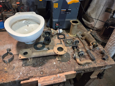

This is the original Baby Blake toilet out of Chance completely dismantled and ready to be check over to see what parts are needed to restore the toilet back to a working toilet once more

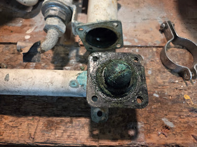

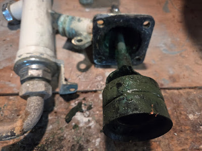

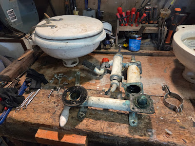

This is the second toilet which we got a few years ago and are now in the process of dismantling and doing the same checks on this toilet to see which parts are needed to restore this toilet back into a working toilet again.
The design of this second toilet differs in that this part is different to the original toilet, We may have to change this part for a modern part which the company who own the Baby Blakes now have as a replacement part.
This part needed a bit of tapping with a mallet and a piece of wood to come out of the pump housing. It is likely it as not been apart since it was build over 50 years ago.

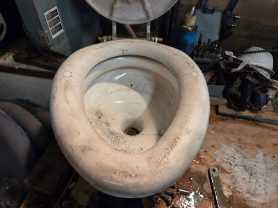

The original toilet as been clean and soda blasted and is now ready to go back together once the parts as ordered and the body of the toilet have been repainted.

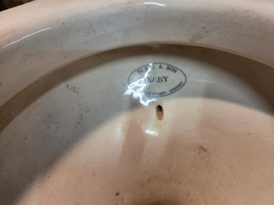

The bowl as got the original factory stamp which dates it to when the Baby Blakes were made and build in Gosport
The major different because the original and the second and third toilets is that the original still has a wooden seat and lid not a plastic seat and lid which the newer toilet were made with and if you wish to have wooden seat and lid you paid extra for as it was a option extra.

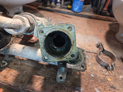

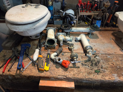

The second toilet now in pieces ready to be washed and cleaned before any inspection can be done.

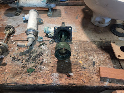

The toilet discharge pump in need of a very deep clean to remove any and all dirt from years of use over the years

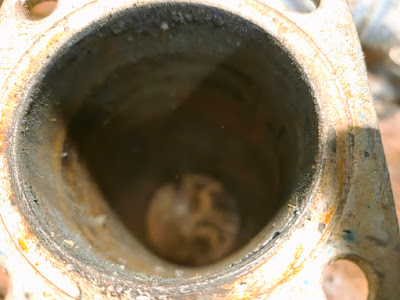

The bore will need a good cleaning and the body will need soda blasting as well before it can be repainted
