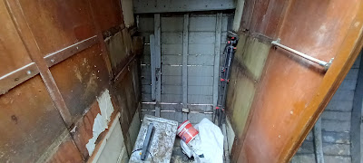

Decisions to be made about the Toilet and the position of the diesel cooker when we refit the interior of Chance back to its original layout

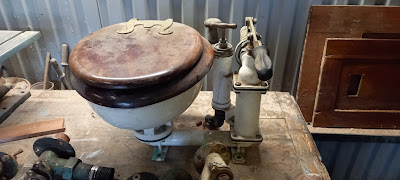

The original Baby Blake toilet has been removed from Chance to under go a complete overhaul and be brought back into commission with new parts that are still available from the manufacturers of the Baby Blake toilet who are still in business to this day. A major result, a new Baby Blake toilet is over 4k to buy today. The repair kit is a little over £200.00 so it is no contest. Repair the toilet.

This is the galley area which has been stripped out and with a bit of re-organisation, the cooker will be fitted in this area.

This week we have been stripping down the baby Blake toilet and cooker, getting the fan body out of the cooker so I can fit the new fan to the fan holder and then refit the fan body to the cooker once it arrives from Canada after the Christmas break. There will be a bit of wiring up to do with the control knob to do and make up power supply. Then repair the fire brick walls where they are broken off the walls of the firebox. We ask if we had to replace the whole of the firebrick walls and were told we just had to clean the bits up and then mix up some new fire cement and fix the pieces back on the metal walls and then fill any gaps with fire cement and do the same to the cracks in the broken pieces and make the surface smooth and flat so there are no hot spots within the firebox.
The Baby Blake toilet is now broken down to a lot of smaller parts, however, not small enough yet. there are some parts that need stripping to smaller parts to get to replace some of the parts that are inside other parts of the pump bodies. So there is a lot of work to do on these two bits of boat equipment before they are back in working order.

Now it is time to take stock of what we have achieved in the way of dismantling Chances' interior and doing some of the smaller jobs on Chance, such as dismantle the Blakes sea toilet which is in need of a full restoration as it as not been restored for a long time. So many of the moving parts are either corroded (bolts and nuts holding the parts of the toilet together) or harden up due to not being used and lubricated and so the rubber parts will have to be replaced as part of the toilet restoration. Another smaller project is the diesel cooker restoration ( the fire brick will need refixing and cracks filling and the burner parts which have corroded from use and age will have to be ordered from Canada after Christmas.
