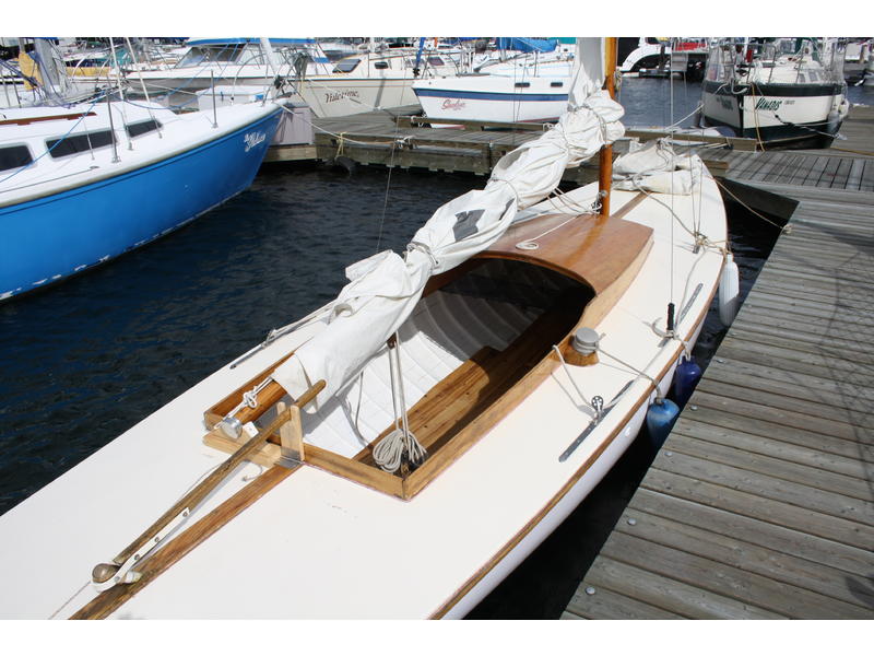

Nothing inherently wrong with the idea of a keelboat; I know because I have one myself. I wouldn't choose a Ff though; you tend more to sit on it than in it. You'd be better too look at a Yeoman or a Squib: both good boats that can take the weather and should be capable of adaptation to provide very basic accommodation i.e. floor space to sleep!
Dragon? I wish!
If I had that sort of budget, I'd be thinking along Achilles 24 lines... :rolleyes:
Dragon? I wish!
Old non-competitive Dragons can be surprisingly cheap: the ones that are actually raced are so ultra-pampered and money-no-object-kitted-out that non-competitive ones are almost valueless. I know of a scruffy but very sound wooden one that sold for about £1,000 - possibly less than the value of the lead in her keel. Dragons are also lovely to sail, very, very pretty, and you can just sleep under cover on board, on older plainer boats without 300 little dyneema strings and pulleys in the well to tweak every quarter inch of the rig.
