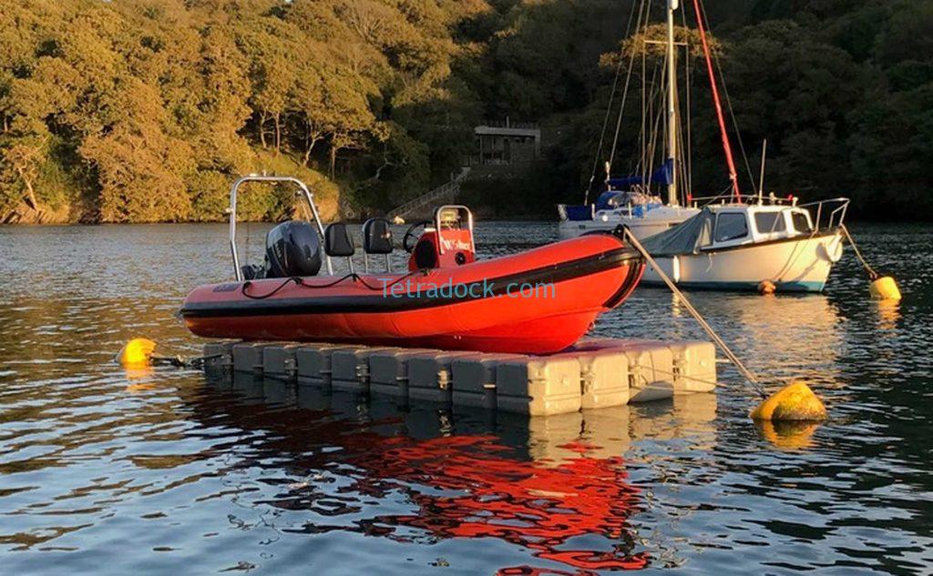

Here's an example of one that isn't attached to a pontoon.
But the dock is attached both at both the front and rear: it's not exactly swinging.
Yes I saw that one on the Tetradock website and it is in Fowey Harbour and I have actually seen it in real life. This was the one that caused me to post the question. I could not moor it both ends but as I said the river It would be in has a very very strong tidal flow.

Tilt you engine back. Usually there is no mooring at the rear. I think the one in the picture is on the side. If it were on a swing mooring there would not be a mooring line at the back
If you have a strong tidal flow I am presuming large tides as well. With the chain catenary required to facilitate significant water depth changes you may find that even with fore and aft moorings on the platform that getting onto the dock may still only be viable within a window period at high tide. It would be worth investigating that with the owner of the RHIB in the photo above if you can locate him.
