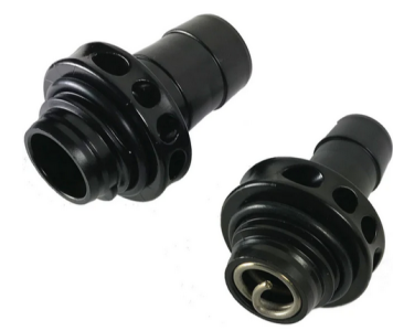

I've just got a new (2nd had) inflatable dinghy which has C7 valves, which I've never had before. On inflation I insert the pump, turn it clockwise and it inflates in no time. But by the time I remove the pump and pull the valve back to the lock position, I've lost about 20% of the air! This seems crazy. Am I doing something wrong?

As Sticky Fingers, your valves are in the deflate position. Put your finger in the valve to depress the valve spring and rotate 90 degree then release. In the inflate position the valve spring is in a higher position than in the deflate position.

Yes I do that and it inflates no problem - but it doesn't return to the locked position when I remove the pump and the air shoots out before I can close it.

then the one-way valve is faulty. Or, when you remove the pump, do you have an adapter that remains in the tender valve? Some adapters have a little piece of plastic in them that retains the one-way-valve in the open position.
Also, when you say "before I can close it", how are you closing it?
