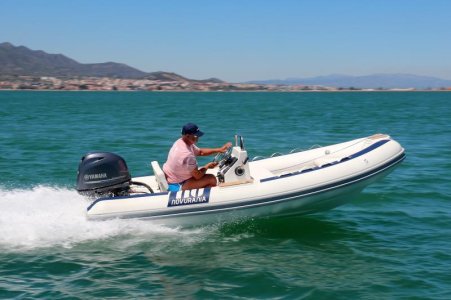

We (and a few others on this forum) bought the Novurania 430DL with a console.
This is a really good tender for doing the stuff you want to do - a group of you going ashore for dinner etc without getting wet.
These tenders are often used by much larger yachts because they do exactly what you are asking.
They should be described as a RIB rather than a tender.

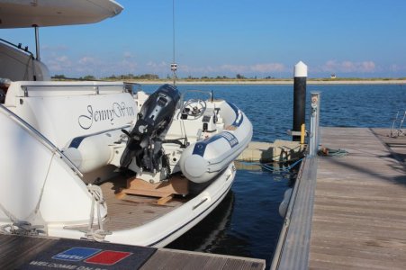

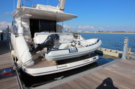

Here are some photos
This one was taken whilst I was "mocking up" the chocks.
The same chocks fit on the flybridge and the bathing platform.

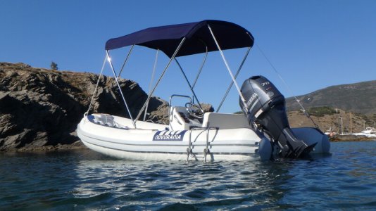

More of a RIB than a tender
We don't use it much but ours also has a Bimini

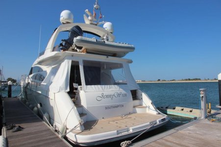

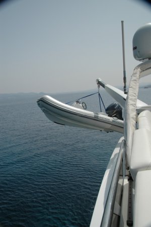

It is probably best to offset the crane to one side of the boat so that you can lift it clear of the bathing platform like this:
(this photo was taken with the old tender - not the Novurania but it shows the process)
However, The crane should also be able to lift the tender on/off the bathing platform like this
At anchor, we position our tender alongside the starboard side - lift and rotate the crane so that it drops onto the platform.
Easily done with two people - or one at a push.
Our crane telescopes as well so that this is possible.
