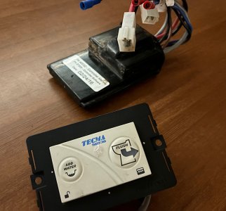

Sorry, should have said, I didn’t have the glass one until I bought one on the advice of Tecma to see if it would make the problem go away. I have these below, which I am told are no longer made and are irreparable, also not available in split parts, so I’m forced to buy the whole new kit. Pad and controller. I’ll probably get the standard 2 button as I don’t need the disco lights and presence detection of the glass ones, nice as they are.IMG_2024-07-10-220017.jpeg
Oh ok. Those are the junk controllers. Should be replaced whenever you come across them. You never gave this info in your original post.
I had no idea Tecma made junk controllers, until your post just now. Tecma have a good reputation for reliable loos. If what you say is true and I’ve no reason to doubt it then it would be fair if Tecma recognised that and supplied replacements cheaply. They are not offering to do that. Just the opposite. Not impressive.
