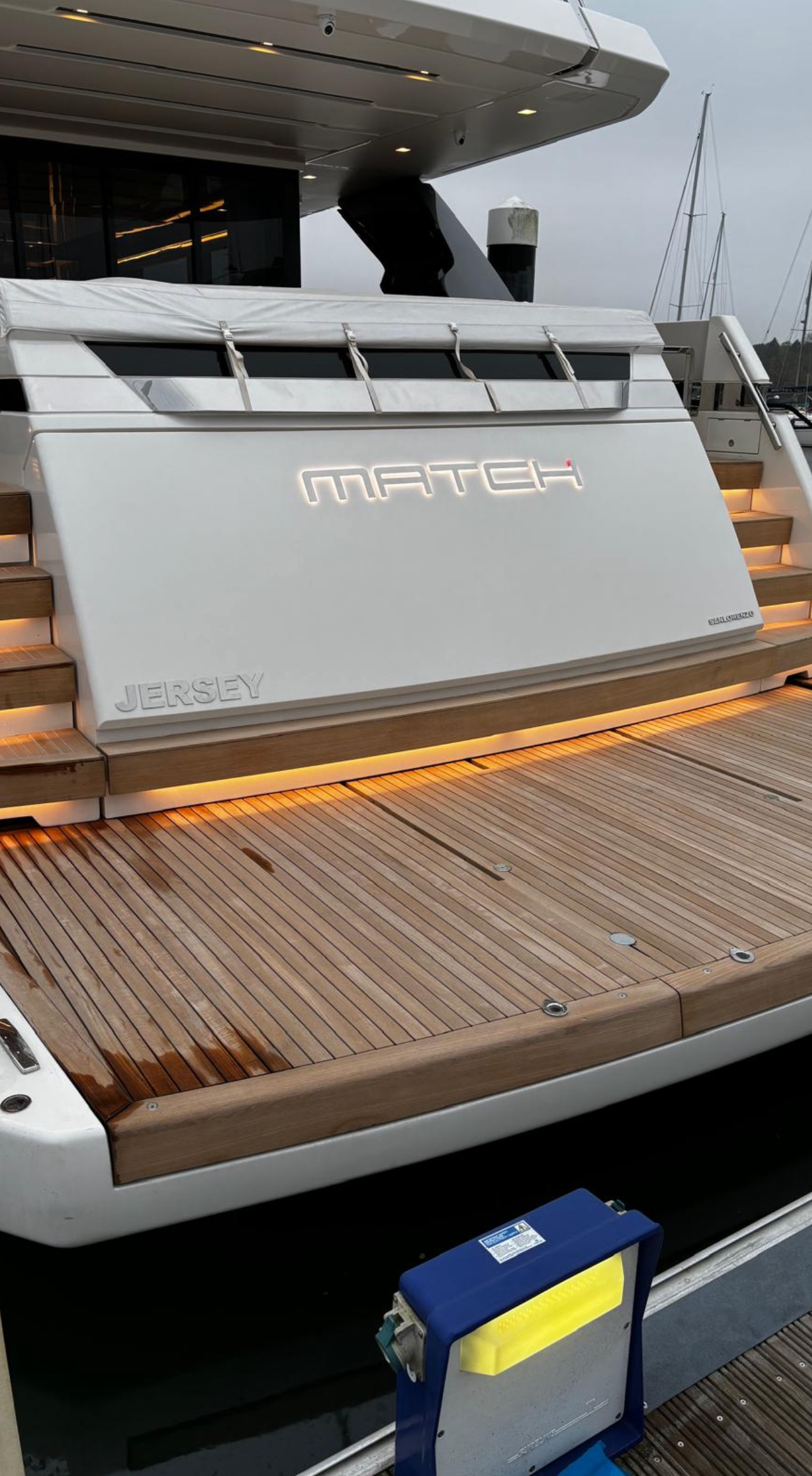

Very personal choice and so no-one is wrong. I wouldn't want "looks like when wet/satin sheen/darker colour" but perhaps you might get that with a water based brown fence preserver. I also don't like the darker look on Porto's Itrama above. I seek a freshly sanded look.
Yes Semco "natural" looks yellow as you say, and I agree with you that it looks a bit disappointing. I would never use it.
The only product I use is Semco in the "cleartone" version, untinted. I have used this many years and it gives a freshly sanded look, no yellow, and after a while it just fades away and you re-apply it. 3 times/year. Incredibly easy to apply because it has the consistency/viscosity of water/white spirit and goes on fast with a foam brush. Brush marks don't matter because it soaks in. Widely used on superyachts.
Below three pictures are my boat (1) on launch with bare freshly sanded untreated teak (2) with Semco top up just applied on 10/9/2024) and (3) last week ie 2 months later with nothing done since the September Semco coat. So I'm a big supporter of Semco clear, but only if you want the straw brown freshly sanded look.
