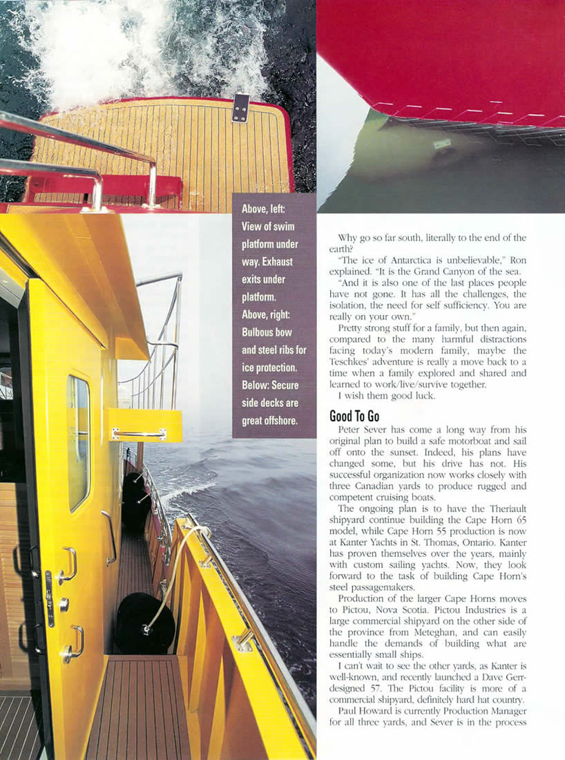

A dozen of years ago, I flew to the US to check out the small ship below, with the mad idea of purchasing her, and the decks are definitely one of the things which impressed me most.
On this specific boat, the first owners (a couple of former sailboat circumnavigators) obviously liked the stuff enough to spec it also for the interiors, as can be seen in the pic, combining black and white caulking.
The following is an abstract from a booklet on CH construction which explains the builder's choice, already 20+ years ago:
Marine Deck 2000 is a highly compressed cork composite made in Holland, quite dense; looks something like teak from a distance (albeit not as pretty); wears extremely well; requires little or no maintenance; is excellent non-skid; is warrantied for 5 years.
It comes in ‘planks’ that a skilled worker must cut and lay by hand, glue them to the deck and caulk the gaps between planks – much like laying real teak.
The glue itself forms an excellent water barrier to protect the steel. Cruise ships have used it outdoors for 12 years.
We have installed it on most Cape Horns so far and everyone loves it.
It says nothing about heat absorption because - I guess - that wasn't a priority for boats built in Nova Scotia... :rolleyes:
But cork is well known as an excellent material, in this respect.

Thanks MapisM for the CH info. I hadn't realised MD2000 had been around so long. It has grown on me since living with it 5 years in the tender and it still looks as good as new with only hosepipe/soap washing. Maybe one day I will do a whole boat in it. I would never use it inside as CH did though; real wood is much nicer and you don't need to worry about the sun. BTW I can't figure out how CH have no caulked joints in the margin boards, even around the corner of the swim platform. As you can see in my pic, my margin boards have the normal joints like real teak
I'm aware of the red/yellow CH - somewhat famous vessel. Good going that you have been aboard. Not sure I approve of fender stowage :D
100% Agreed, I also very much prefer wood for the interiors (and definitely not caulked, btw).
Not sure about the reason for non-caulked joints in the margins - maybe it's just because the caulking is "fake" (I mean, laid by rooting large flat panels), so you can have it in any design you like.
Though coming to think of it, caulked corners would have probably looked more "appropriate".
Yup, CH #4, originally christened "Dream Chaser" was a very peculiar vessel indeed.
She had already been repainted white when I inspected her, but I actually liked her original SAR looking colors, chosen because cruising Antarctica was the original plan of the first owners.
She didn't actually bring much luck to them, but that's another story...
