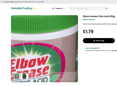

Instead I have decided its best to try to keep the teak as clean as is reasonably possible . I find various mild cleaners like white vinegar and citric acid can be used sparingly and work well . Citric acid is in favour with me at the moment and this will bring out the natural colour of the teak as well as helping to bleach out any stains.
I try to avoid the two part teak cleaner which does work very well but I feel it is quite aggressive.

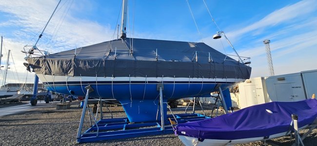

At the moment, I am in the second year of a two year trial of Si:OOX wood treatment.
It was recommended by a friend who owns a Hallberg Rassy, so I decided to have a go on my 23 year old Malo. I have always just used a twice yearly Borocol treatment, and more recently used Teak Treat by Wessex chemicals with excellent results. However, every spring when I come back to my boat there are little piles of tiny wood fragments gathered in little pockets - evidence that Irish winter weather is continually eroding the teak.
Si:OOX is a two part treatment. Firstly a silicon (not silicone) treatment is applied to clean wood which is supposed to 'toughen' the wood. Part 2 is a clear siloxane coat which seals the wood with a permeable, breathable coat which protects against rain, frost and stops moss and algal growth.
I applied the base coat and one protective coat in autumn 2024, and the results in spring 2025 were encouraging. There was very little green mould growth and what was there washed off easily with fresh water. There was also almost no teak fibres noticeable anywhere. I also noticed during 2025 that after a light shower of rain the rain 'beaded' on the teak, but prolonged rain did wet the teak but this dried out which leads me to believe that whatever coating is there is permeable and allows the wood to breathe.,
In autumn 2025 I applied a coat of the protection to the whole deck as recommended, with a double coat in areas of wear, and will report back when I return at the end of April, but so far the results are encouraging.
