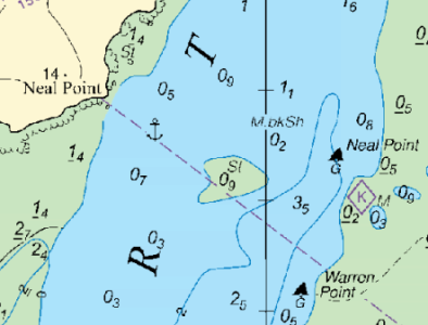

@Wandering Star - just as @LittleSister says, and watch out for the "lump" in the main channel at Neal Point.
Some muppets (cough, blush) have been known to run aground on that.
"Not for navigation"
