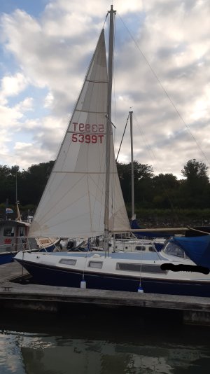

The foresail is not massive, but not original either.
I would agree that she is mostly motor sailer tho lol. Always a compromise eh ?
