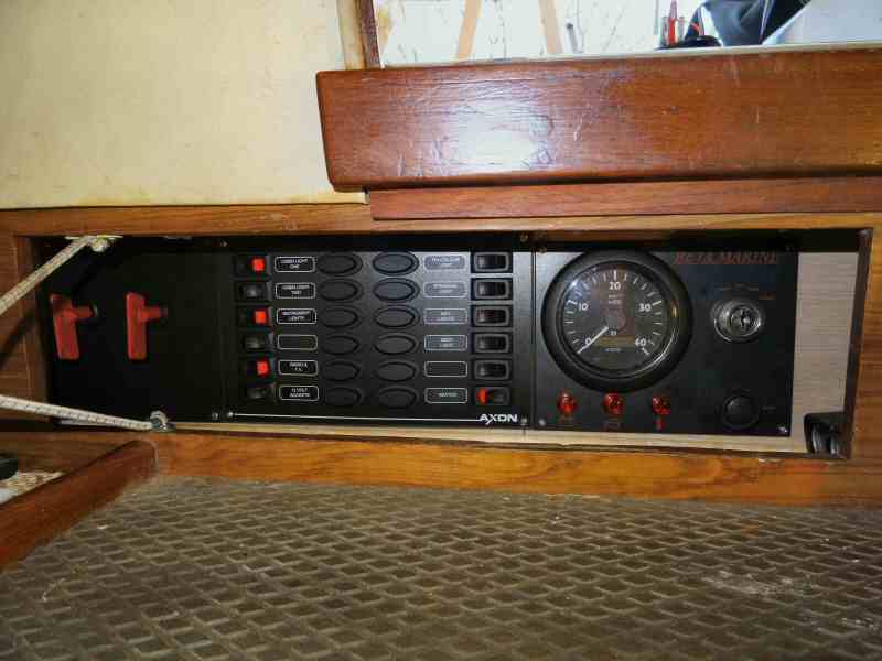

Getting to the switches from the cockpit requires fumbling in a recess you can't see into. To be fair - if they were easier to see they'd be more exposed to any incoming water. From down below I'd say getting to the companionway or chart table is about the same.
Why keep the switches under the companionway? On my Stag28 I inherited a mess of wires there - so moved them to the chart table where they should be...
A neat solution. I did very seriously consider it... for about 5 minutes. I had visions of a nice big switch board and a mimic panel just above the chart table. The thought of removing the head, side, under shelf, over berth linings and re-routing all the wiring (not to mention the cost) caused my enthusiasm to evaporate somewhat.
In mitigation I submit a couple of 'before' pics. All the wiring is in the slot under the bridgedeck which is rather narrow. It is almost impossible to use busbars that are screwed to the base because you can't see what you are doing when trying to attach wires. The wires need to be long enough to pull the switch panel(s) out onto the cabin step to do any work.

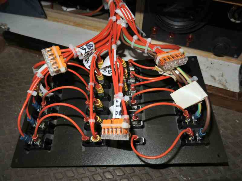

Hmmm, yes. The back panel, on which the engine control panel, switch panel and master switches are mounted, had to be cut in half to get it out from under the bridgedeck. I made a new back panel in 2 pieces to get it back in. There isn't any way the whole panel could be made demountable and fitting bus bars/connectors to the back of it is just not going to be possible.. The bundling of wires and 'swan neck' are sort of happening (more of a duck's neck). The negative busbar and connectors for multiple circuits I think will be fitted to the baseboard of the slot. As they will be done with Wago connectors I wouldn't have to use tools under there to make amendments in future.

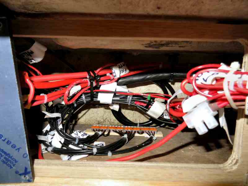

OK. Finally got everything finished, panels back in and all circuits tested.
It's still not pretty back there but at least there's some sort of logic, wires are (scruffily but accurately) labelled and they are bundled rather than emulating a snake mating frenzy.
Photos for the amusement of professional wiremen and the delectation of any bodger worse than me.
Thanks for all advice/assistance.
Take it from a professional wireman.... thats a good job you have done there.
One thing I would suggest. When you add cables to a bundle that is already cable-tied, remove the ties that are already there.
I agree with Dougal. You should be very pleased with that. The Wagos do a good job of keeping that switch wiring neat, immeasurably better than a stack of piggy back spades. :encouragement:
One other comment, fancy leaving that lone choc block in the foreground :beaten:
That's incredibly kind of you, I was expecting gentle flak.:)
I did wonder about that. It's the main power feed from the house master switch to the switch panel. I could probably replace it with a big butt crimp. Would that be better?
If it's too big for a Wago a crimp and some heat shrink would be nicer than the chock block.
