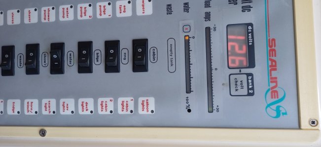

Hi All.
The Amps Load indicator on my switch panel always shows nearly plus 30 amps. Even with nothing switched on. I assume not normal and I have a power drain on something? Not sure what a minus reading would indicate either.
Any thoughts please.

Is it showing +30 or -30 ?
-30 would be a huge drain, unlikely.
+30 could be the mains charger is on, but i wouldn't expect it to be always at +30
Regards, Paul.
Went to boat today. Disconnected mains, indicator stayed at plus 30. Turned on everything, "domestic" dropped a little to say plus 25... so I assume the display ( or the bits behind it) is knackered!
