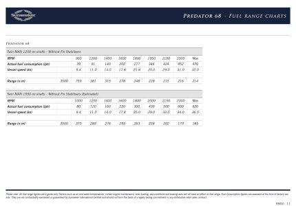

Sunseeker does publish fuel burn and range charts, they're just not made widely available to the public. Here is the chart for the Predator 68 from the booklet produced in October 2017.
My guess is that the values are for boats fresh from the factory at half load tested in UK waters. Fully loaded in the Med, and with fin stabilisers, you will not achieve these values. For example my P57 which is fitted with fins is generally about 10% worse than the published values across the board.
Is that for the Mk 3? I think it was around that time that the Mk 2 was discontinued.

Anyway, it's interesting to see that my guess was right on the money only at the low(ish) P speed of 18 kts, while at 25 kts (which isn't exactly warp speed, particularly for a boat that pretends to be sporty) it goes up to almost 14 l/Nm.
