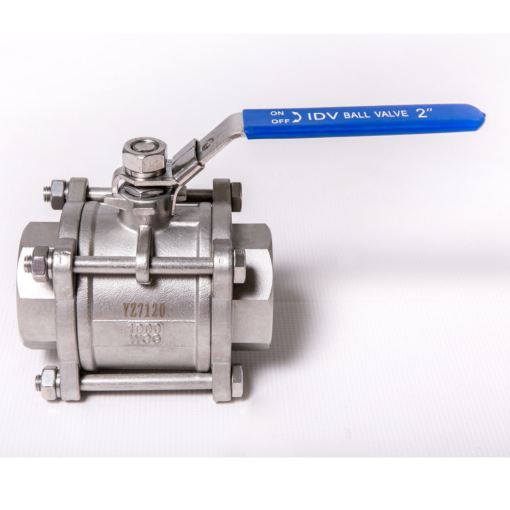

Due to the "propeller coming adrift" adventure on our last week long cruise, I've not been to visit Mirage as much as I'd like as she is a couple of hours away. On my last visit, I worked all the seacocks.... apart from the aft heads outlet that appears to be stuck!
It has always been a bit tight (when I purchased the boat I was concerned, as this head had been used for storage, it was truly stuck, but with some persuasion it came free), and this just happens to be the only seacock and skinfitting that has been changed by the previous owner (it's on the boat "todo" list to replace all skin fittings).
It looks to be of good quality, and dezincification resistant (I read the DR there)
Previously when its been a bit jammed, I have tugged it a bit harder, and it would free up... I feel this time I would need to apply extra leverage to get it to move. Is this a great idea? Or wait for lift out and inject some rydlymn up it and then replace with the rest.
Edit: It appears to be one these:
Aquafax Isis DZR Brass Ball Valve - Fox's Chandlery (what documents I can find here:
https://www.specifiedby.com/relianc...s-with-t-handle_specifications_1_b84903c6.pdf)
