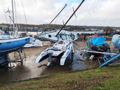

Boats used to have their masts removed for winter, maybe yards stopped doing this because masts take up a lot of room, maybe because of damage stepping and unstepping, or cars reversing into the masts in storage. I had my halyards stolen from my mast on a rack once. But when you see this picture, it kind of makes sense to take it down.

Difficult to tell from the photo but the larger boat is a shape that is really difficult to shore with its pointy ends, narrow keel and fat middle. I think in our club the yard would probably require a 6 leg cradle

A traditionally shaped boat - long keel, etc is pretty easy to shore, and severe storms were rare, so propping boats worked, but climate change does seem to be bringing stronger and more frequent storms and, at the same time, a modern deep, skinny-keeled boat is harder to shore up. I could easily see insurance companies starting to require proper cradles and, possibly, masts removed, though a boat in the right cradle would need truly exceptional wind to tip it, even with the mast up.
I do wonder how the mast on Mad Hatter came down. Did something hit it? It looks too far from the tipped boats for their masts to have reached.

We're these boats in proper cradles, or were they shored?
Our boat is propped. A dam sight more stable and secure than 4 leg cradles if done correctly with 3 or 4 props per side - pity folk have forgotten how to us cheap logs but want expensive cradles that lock them to one marina.
A simple tie rope to ground bolts would help if windage aloft too much - our hut on Portland Bill has it for the roof as does the Navigators allotment shed so its not a new idea or rocket science. Kingstone Boatyard need to up their game perhaps
