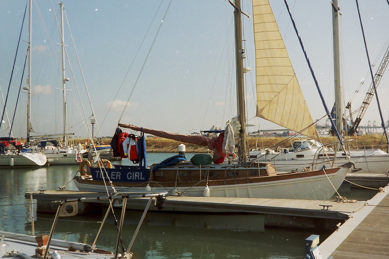

TG's original Jeckell suit of sails 1964: Storm Jib is 87 sq ft, Genoa 281 sq ft, No 1 212 sq ft, No 2 Sq ft 153 sq ft. Storm Jib in 9 oz cotton, wire luff - but I guess that isn't particularly relevant these days.
Out for drying - a not so nice day earlier in 1992:
DSC01379 by Roger Gaspar, on Flickr
