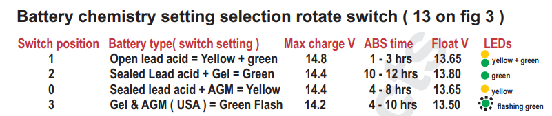

There are two reasons why the warranty might be invalidated. The fact that fitting the Sterling regulator requires adding an extra connection internally and perhaps increasing the output.
There may be little or nothing to gain by fitting the Sterling regulator to a modern alternator.
Once you have installed the new engine measure he maximum voltage achieved. If it comes close to the figures in the Sterling instruction manual there will be nothing to gain by fitting the Sterling regulator
