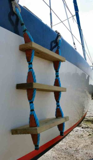

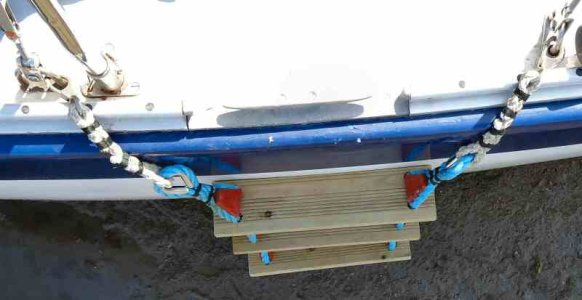

Depends on height - We have a fat one like an 'Anchor Marine Step Fender' - to get in and out of the dinghy - set at the side by the rigging - hold on to the rigging while stepping up - works well with the one cord - once set at the right level - nice and fat - can get the hollow arch of foot on it so nice and steady, one rope so easy to lift onto deck and also used as dinghy fender. Set it over dinghy when using so can only fall into dinghy if fall. Tried a multi step like the blue one but too slim, can only get toes of foot on it so unsteady. Tried metal folding steps but fiddly. Have wooden rope ladder too like above if ashore. Plan one day to make a proper fitted wooden boarding ladder.
