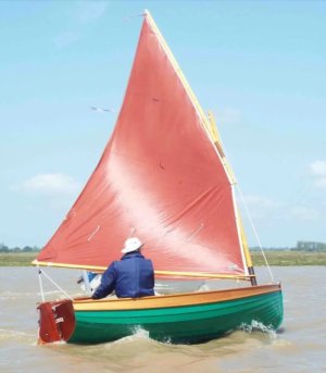

I have a standing lug in my 11ft dinghy with a boom and I have tried boomless too. First,with no boom on a short boat it is near impossible to get the sheeting position far enough aft to get the right sail shape when close hauled without needing a bumpkin. Second, once off the wind on a reach or run the sail will tend to bag and you will loose significant sail area unless you pole it out. So, you may find that needing a bumpkin and a long pole will be more complicated than having a simple boom. As a result my standing lug sets very well so making the boat so much more enjoyable to sail.

I have a standing lug on my 14' Lune Pilot. It is loose footed to a boom for all the reasons given above. The Lune Pilot also has a tiny jib on an even smaller bowsprit which really helps with tacking. Sails like a dream, no centreboard just a shallow long keel, surprising lack of leeway too.
The unstayed mast is brilliant too. On a run, just letting go of the main sheet means the whole sail can weathercock and spill wind, very reassuring for a numpty like me. There is a very informative website about these boats and the rig, just google The Lune Pilot.

Yes, am certainly aware of Roger and I agree with you about the disadvantages of a boom but if you can't get a good sail shape you will soon get frustrated and will not enjoy the sailing. My little lugsail dinghy sails well, on all points and will even sit comfortably roughly head to wind gently tacking side to side with no input from me. I cannot get anywhere close to a good sheeting angle without a boom.
I converted my 11ft sailing tender to a boomless standing lug and it's worked very well. The sheeting point is well aft and when on the wind I seem to get a decent sail shape. Off the wind I can lose a bit of area but if I remember, I bring a boathook and can use that to pole out.
