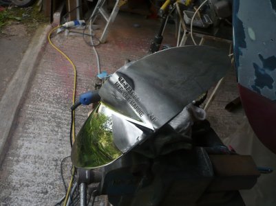

Having not had stainless prop's previously I thought I'd try polishing mine ready for when the boat is complete next season. Took about half an hour to do one side of one blade but it looks OK. How far do you need to go to stop things sticking?

Is that one of two, from a B3 ? Love a merc stainless prop me. Have far too many currently! Enertia, tempest plus and a couple of laser 2
Keep them nice…have you seen the price of them, should you ever have to replace them 😳
Well there's a story to go with this set. I bought them secondhand off Ebay from a Thames boatyard for £85 described as aluminium with one damaged blade. When they arrived I thought they were heavy for ali' but never mind, sent the damaged one off to Steel Developments and they came back and said it was stainless and would cost more to repair. Rather than being annoyed at the extra cost I was pleased to find they were stainless at a real bargain price. Cost about a hundred and something for the repair so I was still well in pocket. So I will keep them nice!
Haha. Excellent result there. Love hearing things like this. Yeah…you did very very well there ! Recently a friend of mine managed to get a hold of a set of 26” B3 stainless props off eBay. Without doubt the cheapest I’ve ever seen a set. Needed a wee tidy up…bought for £395 at that. Just to emphasise what a bargain you managed with yours ! They are usually considerably more expensive, in any sort of useable condition and will surpass 4 figures in mint and of course new condition
