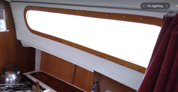

My old boat had h section ally frames, and I never could get them to seal. Eventually, I cut them down so the h was an l, which I used as an external trim. The new perspex was sized the same as the outer edge of the frame and through bolted to the cabin sides using the original holes and butyl tape. The inside trim was made of 3mm ply. No more leaks!
The outside was a bit thicker than the original, but you wouldn't notice unless close up and looking for it. The inside looked like this
