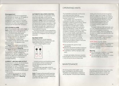

Exactly. Unfortunately, it does not learn differences in how waves affect the boat as the wind increases. Oh well, how much can you expect from a drop-in pilot?
The TP's even as old as my AH800 and AH1000 - pre-dating the Raytheon take-over have seastate that they literally learn as boat moves along ... of course it cannot catch sudden shifts or unusual .. but its better than being completely dumb.800 & 1000 Sea State auto.jpg
I'm told its even better on later ST models ??
