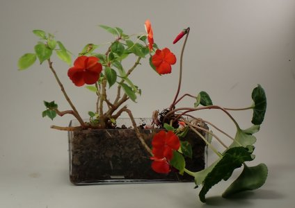

I once grew a houseplant in some rotten core that I removed. It did quite well. It was really very much like potting mulch.
It can be an adequate half-assed repair in some cases. The bond and stiffness won't last because the rot and the balsa the epoxy is bonding will turn to mulch. You just filled some gaps, and when the core around the epoxy rots you are back where you started, with some loose epoxy lumps in the core.
