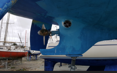

Due to the poor maneuverability of the S 110, I looked into the question of a stern thruster and found the following picture. The cost would be 5600.- in pounds . What should we think of this?

The standard fit in the Southerly was I think Sidepower SE60 - that is what I had in my Bavaria and also in my current boat. The stern thruster in your photo looks like it is in a 110mm tube which limits power to 25kg although looking at the blades it may be a Vetus unit rather than Sidepower.
The price you were quoted sounds about right as there is a lot of work in the tunnel and doing all the cabling. My view about the money side is that if it makes your life easier and it means you get more and safer use out of the boat then it is money well spent.

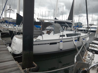

The photo shows my Bavaria with the Southerly on the right and Freedom behind. All owned by elderly gentlemen with decades of sailing behind them.

I think a potential problem is the thruster doesn’t look like it’s completely astern ....this could cause sideways movement..which is what you want...but it might have to work harder than if it was on the transom and therefore not be as effective.
Of course I’m only going by your picture which might not show it’s true position
