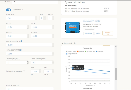

Why I really like the Victron calculator linked in a previous post ... you can see exactly where the voltage lies between the max voltage and the Vstart and Vrun voltages of the MPPT over the complete temperature range.

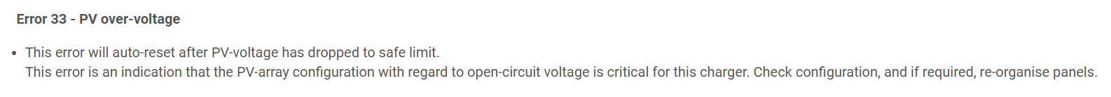

The Victron Connect App will give the message "input voltage exceeded" and the controller shuts down if the voltage exceeds the controllers rated voltage. There may be a limit to the amount the rated voltage can be exceeded, i don't know.
I'm not suggesting people fit under rated controllers, but i know for a fact that some protection exists.
Baggywrinkle
6 Mar 2010
10,104
Didn't know it did that. (y)
Edit: Found it in the Victron Community ...
mppt 150/100 error 33 input high voltage - VictronEnergy

.... using single, smaller 12v panels, the calculator can't find a suitable MPPT for panels @ 70°C.
Yes this is a good point. The Victron units have a high wake-up voltage set at +5V above battery voltage. Once the wake-up voltage is achieved, the solar panel voltage has to be +1V above battery voltage to continue operation. On some brands of controllers, the wake-up voltage is adjustable. It is a pity Victron has not incorporated this into their software.
In practice, this seems to very rarely be an issue, but you do need to be careful about teaming the Victron controllers with "12V" panels in parallel, especially in high temperatures, if the panels have a Voc on the low end of average, when the overnight battery voltage is kept high with secondary charging sources such as wind and if the solar panels have minimal ventilation.
If you select a very high panel temperature of 70°C as you have done the Victron calculator correctly warns that this is not a satisfactory combination because meeting the start up conditions may be delayed especially if some of the other factors mentioned above apply. 70°C is a very high panel temperature. The most I have measured on my rigid panels was 54.7°C in Greece during summer at solar noon on my previous yacht.
In very hot conditions with no panel ventilation I can imagine that 70°C could be rarely reached with some installations perhaps with soft panels glued to the deck, but I have never personally seen temperatures this high.

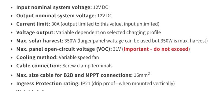

Stirling DC to DC/MPPT does too
Keep in mind the specifications for the unit warn in red letters not to exceed the maximum input voltage. The manufacturer obviously feels that a mechanism to shut the controller down will not offer protection from an over voltage condition. This warning is echoed by many manufacturers.
Note there is no such warning on the current input. The specifications even spell out "input unlimited". The unit it will protect itself reliably against currents higher than the maximum rating, but not against voltages higher than the maximum rating. This is true for most solar controllers.

If the manufacturer warns "Important - do not exceed the input voltage" (Sterling) or "Exceeding the maximum PV input voltage rating will destroy the MPPT" (Victron), then obviously no effective protection for exceeding the input voltage exists.
The vast majority of other manufacturers have the same warnings, although there are some rare exceptions, such as some of the Midnite controllers with their "Hyper VOC" circuitry.
Suggesting that the solar controller will protect itself against input voltages greater than its rating as you did in post# 39 (see below) is wrong, or at best misleading, advice. They don’t just shut down; in many cases, they are permanently damaged (or destroyed, to use Victron’s language).
