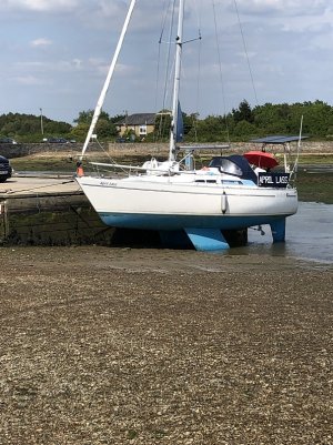

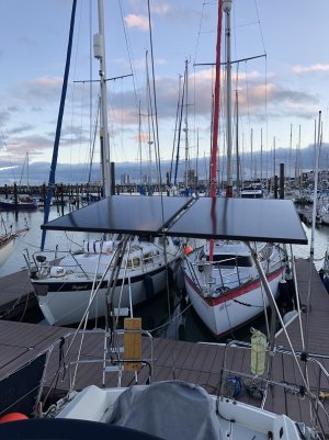

One February 6 years ago we bought a cheap second hand rib A frame from a boat yard in Cowes and bolted a 150w solar panel to it. Worked brilliantly. Then increased it to 300w so we could add a small Alpicool freezer, which was good and in Nov 22 upped the solar to 600w. Panels weight 34kgs and the frame about another 15kgs. The weight is off set by not carrying a pair of 11Kg Calor gas cylinders around. We are careful not to carry lots of other junk on the arch or stern apart from the little Honda 2.3hp. She still sit on her marks.
The last reiteration did raise some eyebrows, particularly when I said I planned to plug into the pontoon shore power sell the surplus power back to the club. Meanwhile we cook on sunshine. However, it took an awful lot of searching over some years to find a frame that would fit and at a sensible price.

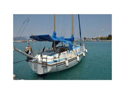

It's not a ketch.
We run 920w of solar on our ketch with no monkey bars🙂
Yes I am aware of this, hence the picture in post 7.
However, just needs a bit more framework to support the arch off the back :unsure:
Something like this perhaps? after all he did say cheap as possible:

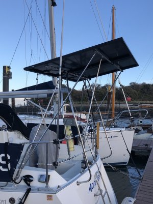

I spent around £500 on my setup which carries 730w of solar. The stainless and the panels were all secondhand which explains the price. I needed around £150 of welding and £100 worth of tees, clamps, etc, to assemble it all.
