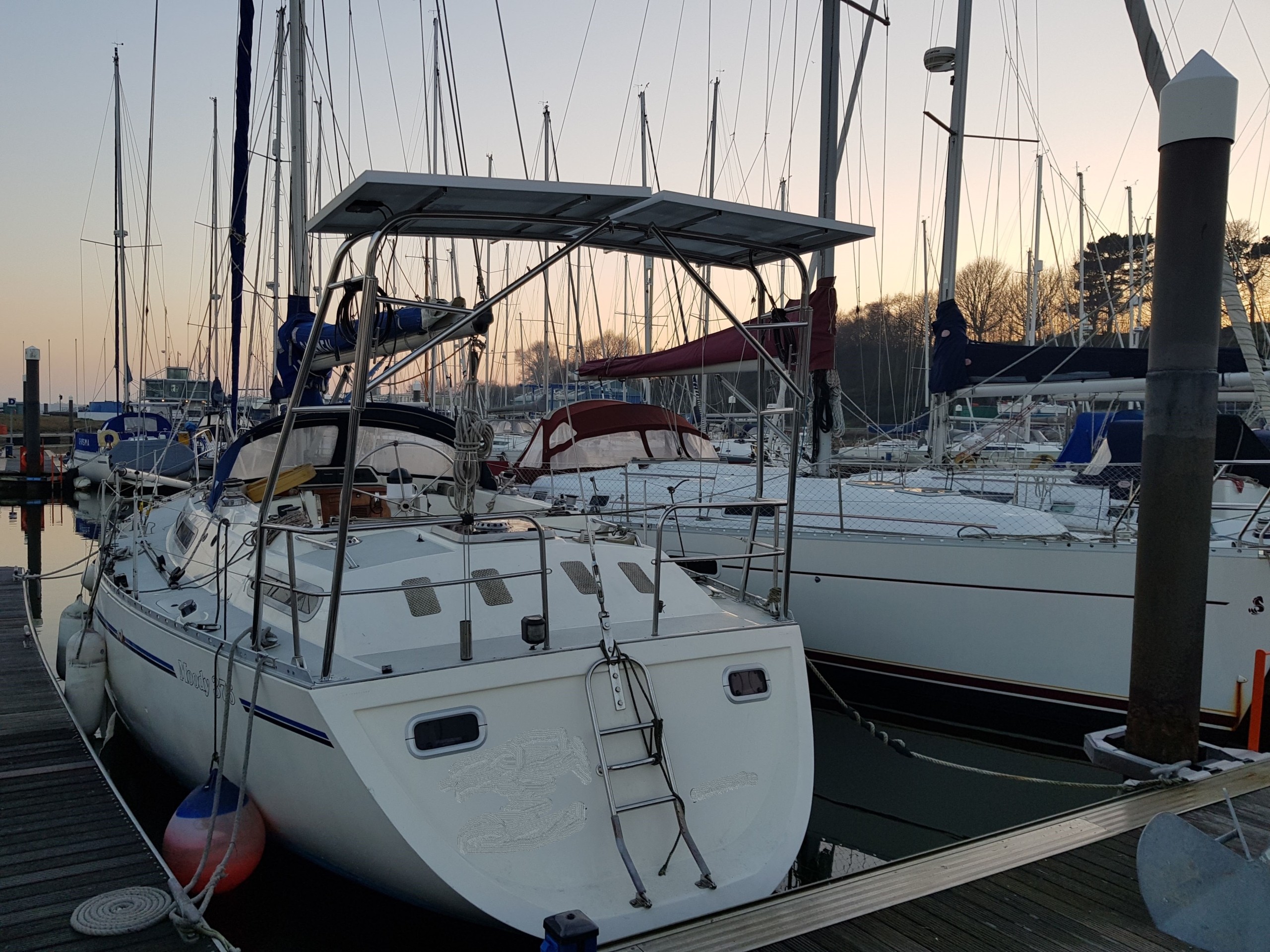

It would be an arch for me Dave. You could have one made that incorporated the pushpit and would easily support 400w of solar. I had one made last year for a Moody 376 that we fitted with 400w, all built into the boat so it looked really nice and it had a pair of stainless davits too. Not cheap, but as a long term investment, definitely the way to go.
Not quite finished here:
This is the finished article, just waiting for me to connect the panels. We also fitted a GPS antenna and an emergency VHF antenna. The swing out davits would have been perfectly suited for MOB recovery. Hard to see in the pictures, but there is also a set of fixings on the front tube that could be used for fitting a bimini :
