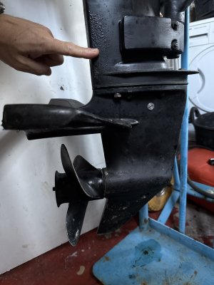

Thanks for everyone’s responses. Took the engine out for a run on the water yesterday and you were all correct, it runs well. Smoked at first but that died down when it had run for 15 minutes or so. Telltale is running nicely and the only thing of note it a slight colour in the water when moored up idling…oil or petrol sort of slick but guess this is normal on an old engine? I have just drained a little gearbox oil and would be grateful if your comments??IMG_9433.jpeg
