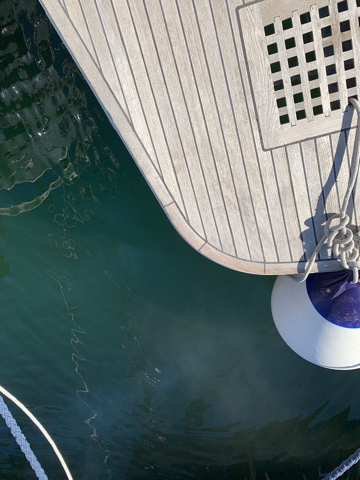

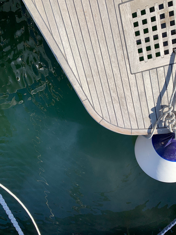

but still the same smoke,
dark grey blue ish
see pics below
welcome any advice !

Looking at the pictures it looks like unburnt fuel how many hours on the engines are they running at 3000rpm or 1500rpm do the genny's run for long periods on low load setting you say 4amps at 230v = 1Kw do they just charge battery's?
