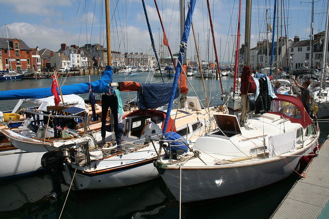

It's got to be a sheet of ply as I need to convert the hatch opening which is currently cambered side to side. Basically I need to belt sand the fore and aft edges so they are flat and epoxy/bolt the wood in place to make a flat surface to bolt the hatch onto.
I think I understand what people are saying about P38 etc...personally I would have used epoxy with plenty of fibres/bubbles, however it won't work without the wood as the Houdini hatch has quite rounded edges and the existing aperture is very square, so there's a gap at each corner.
Picture is worth 1000 words...my boat is nearest to the pontoon.
