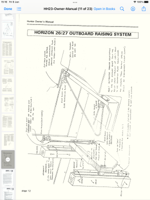

The Horizon 23 outboard bracket is a slide and tilt mechanism, very clever, but needs a big , long well as the outboard lies flat when raised; you say it can’t tilt?
The Hunter 26/27 had outboard in well with rig to raise it. See attachment. If it’s a small out board you don’t need a complex pulley run tho’.
