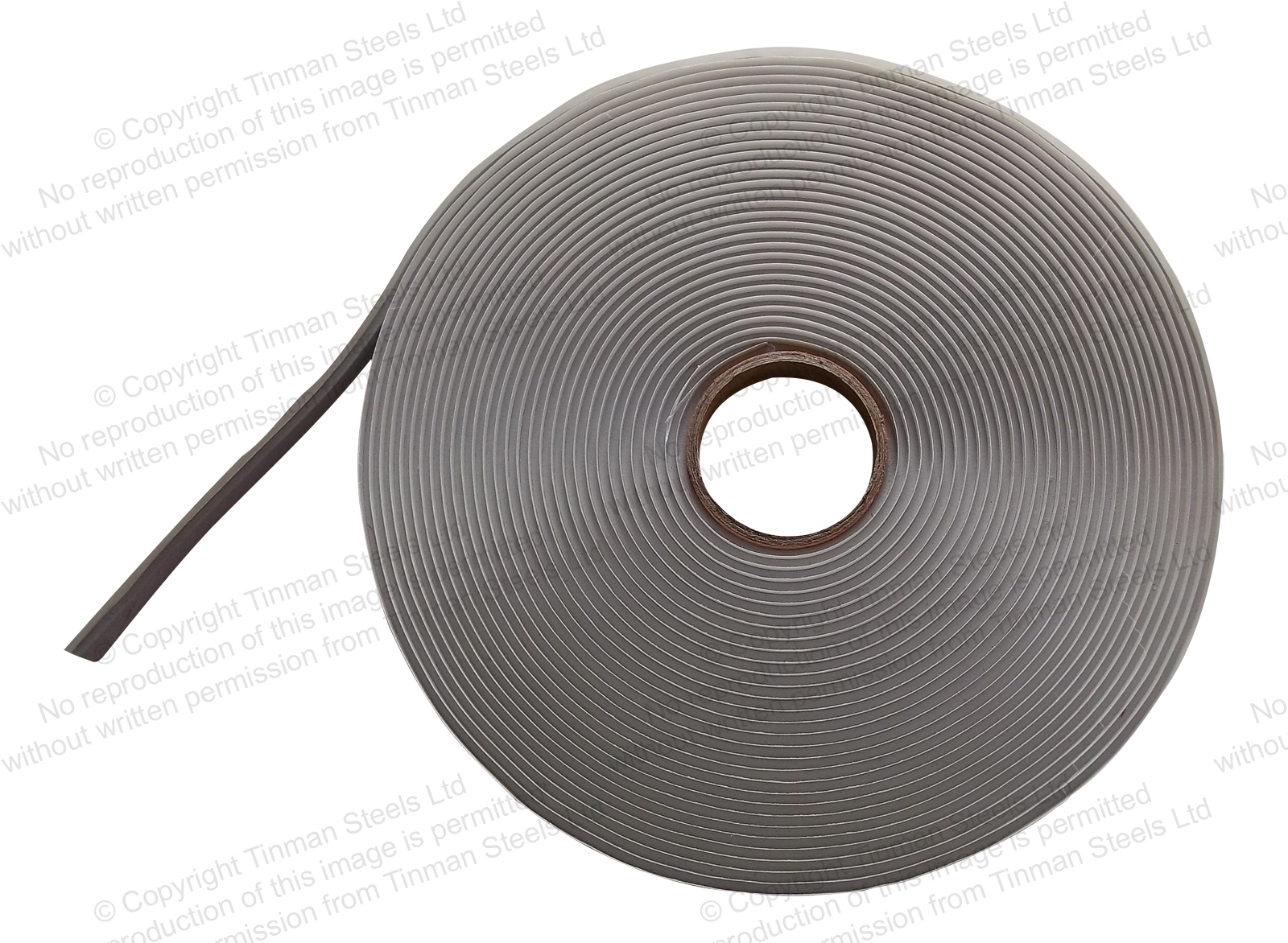

Butyl mastic doesn't dry out and is clean to work with. It remains flexible, lasts indefinitely (no wasted cartridges) and will permit thermal movement in your iron gutters.
It's readily available on ebay and elsewhere.
