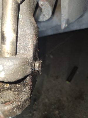

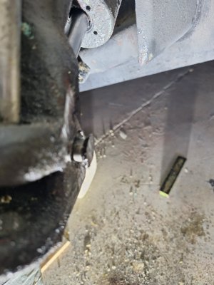

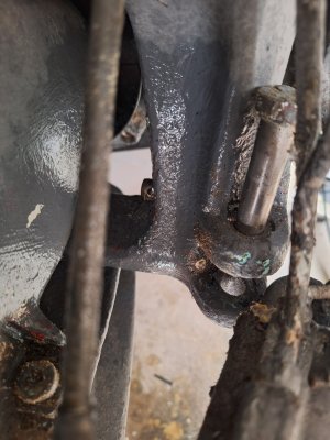

Had the same issue as the OP and thanks to the posts in here was able to get the pin out enough to cut the head and then drive it back through, cut in half and drive again.
Was definitely a two man job requiring a solid metal block to act as a wedge for the wide chisel. Also used ACF-50 as couldn't find plugas locally.
Heat didn't seem to make any difference.
Does anyone have the part number of the new pins with the revised design please. And what's the best to lubricate the pins with for the season before putting back in.
