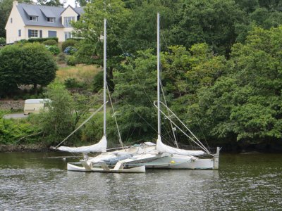

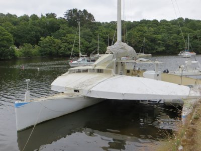

Saw a couple of Proas in France this year. Couldn't work out the push-me-pull-you look of the first one.
If the rig confused you, I suppose they just moved the sails out of the way for living onboard while at anchor... They just cleared mid ship, by turning the sails opposite each other, though when sailing they Will both go aft.
Both interesting, by the small ama's I assume both are Pacific, the second one looks like it has a Balestron rig, yet still has shrouds to the ama, these rigs are unstayed, yet here the builder rightfully added a shroud, keeping the vessel simpler, lighter and much stronger...
Thanks for sharing, great stuff!!!
