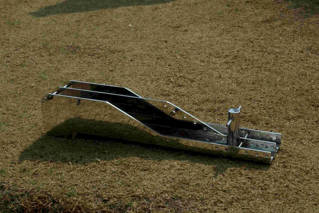

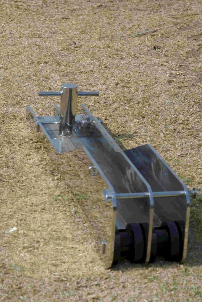

This is my bow roller fitting
This may be over kill for your boat but all 3 side lated cutout and polished but angle grinders with cutting, grinding and sanding disks
This will show you some of the stainless that was made some by me some by a friend for my boat.
