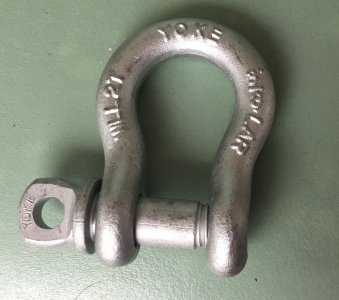

Yoke, the Taiwanese manufacturer of lifting components have recently opened an office in the UK and have a chain of distributors across the country. They are claiming to hold an extensive range of products in stock.
Within the range they manufacture galvanised bow (or anchor) shackles to a similar specification to Crosby's (and Peerless, Campbell both of the US).
These shackles are defined variously but are all G80 shackles.
You can buy Green Pin, Van Beest, shackles to the same specification but not as small as a 3/8th" shackle.
Having a new entrant to the market might make it easier for those who need a replacement shackle to possibly have one geographically close to where you and your yacht lie. I have no idea if they are stocking this specific quality.
These are the specification of the specific range, they make others of a lesser quality.

I have tested their 3/8th" shackles and other components and they meet specification.

I was mulling over the problem that develops when your shackle is too wide and rams the bow roller cheeks when you retreive the anchor. This problem is exacerbated as bow rollers appear to have become thinner and thinner - or less and less wide.
I have not tried it, yet, but wonder if an option is:
YOKE振鋒企業
Grind off half of the hexagonal head, allowing the head to lie inside the 'profile' of the 'bow'
Drill a new hole through the shackle pin at 90 deg to the existing hole but have the new hole flush with the half nut. Then shorten the shank length, maybe rounding what's left of the pin. You can then still mouse the shackle pin but it should run more smoothly through the bow roller. The new hole will allow mousing and hold the supplied half nut securely. For belt and braces use some Loctite on the supplied half nut.
I cannot think the strength of the shackle has been compromised.
I have not modified a Yoke shackle, I only have 3 left and I bought them direct from Taiwan before their ideas of a UK operation were even a dream. I made a modification for another shackle by simply cutting off the protruding lug, but leaving a shoulder on the shackle pin, otherwise the shackle pin can be pulled through the eye. Slot the end of the pin for a big flat screwdriver Then simply using, red, Loctite to secure the pin.
Shackles as recommended, like these 3/8th" shackles, are grossly over strength, failure strengths will be well in excess of 10t. Do not forget that a shackle locked up at 90 degrees to the 'correct' loading direction will lose half its strength - I've tested it - the 50% loss is correct.
Good shackles like these Yoke shackles are effectively bullet proof and cost peanuts - and offer you full security. You can also source G80 shackles from Crosby, Peerless and Campbell - but if the new Yoke distribution is good (send them an email and ask, and report back on the forum :) ) - maybe Yoke will be easier to source.
I have no financial interest in Yoke - simply want people to use the correct shackles and convenience in sourcing should make the use of incorrect shackles inexcusable.
And if you buy - buy a spare. They are easy to lose overboard, guess how I know. :(

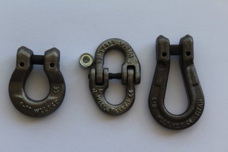

Most bow shackles of the design in my links are to universal sizes. A Crosby 3/8th" shackle is the same (or similar) size to one from Yoke, Campbell or Peerless and they have similar specifications.
If you want a different size and/or design connector with a decent specification look at hammer lock or omega links.
Most companies making for the lifting industry supply a range of connectors, Yoke, Crosby, Peerless, Van Beest with their Excel range - I think all offer hammerlocks and Omega links. Omega links are not common on the anchor rode but a number of members here use or have used hammer locks. We used Omega links with our 'downsized' HT chain as enlarged links (the Omega is G80 or G100) and accepts for size a G80 shackle and similarly used hammer locks for our anchor(s) and Boomerang (in the picture).
There are a number of options.
