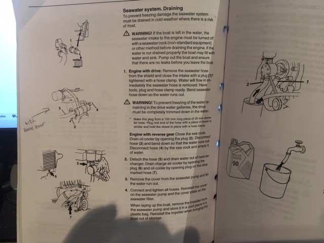

I have winterised many Outboards and Now come to my Sealine S24 with KAD 32 and DPE Outdrive
The Freshwater Cooling side of the engine is fine and has plenty of Antifreeze in it. I am about to have the boat lifted for the first time (in my ownership) and want to make sure I get some Antifreeze in the leg and the Seawater side of the system. On my outboards and indeed my Mercruiser drives I would just use Muffs and a bucket full of water/Antifreeze mix.
Looking at the drive the water intake is very near to the front of the leg and I am not sure Muffs will fit and provide a reliable flow of water. I have read the manual and it talks about removing the hose from the Bottom of the impellor unit and putting a second hose on this into a bucket of water. This looks quite difficult given the space I have in the engine bay and also would not get any antifreeze in the leg.
This Engine and drive is very common so I was wondering how others do it when their boat is out of the water. If anyone successfully uses muffs I would be very interested as this would be my preferred method.
Thanks
Dennis
